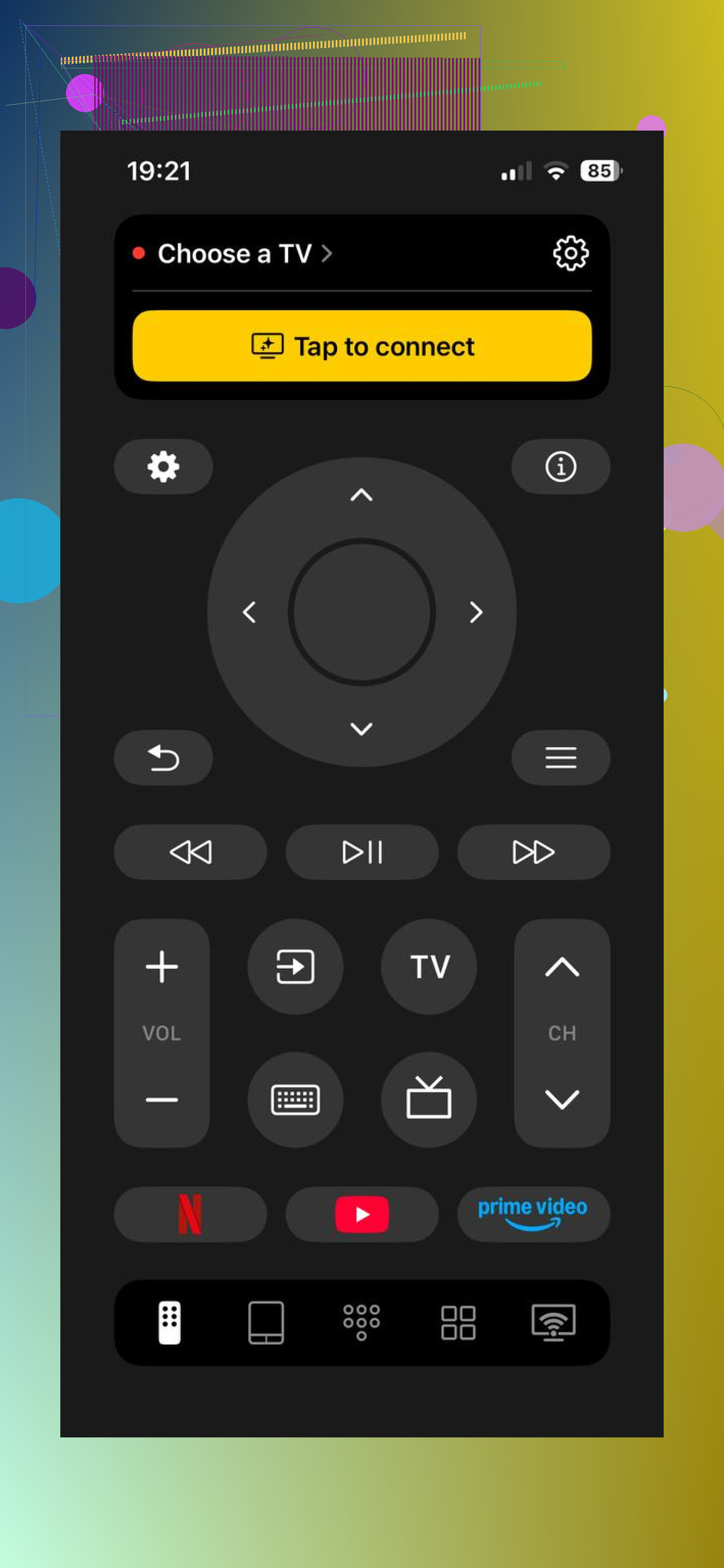

You can also use a universal app like TVRem. Universal Remote Control TVRem works over the same Wi-Fi setup and gives you the usual remote controls like volume, channels, and navigation. The useful part is that it supports Samsung, LG, Roku, Fire TV, Android/Google TV, and Apple TV, so you don’t have to keep switching between a bunch of brand-specific apps.
It’s free, doesn’t require a subscription, and doesn’t spam you with ads. It’s also rated 4.8 from a couple thousand reviews. More details here: https://ios.eltima.com/tvrem-universal-tv-remote/
