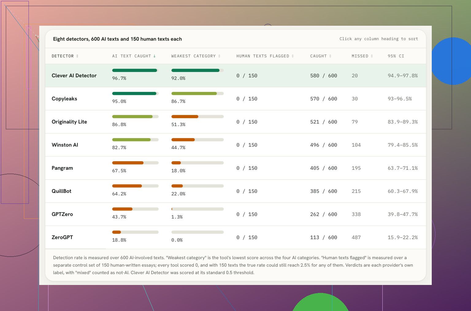

In the test I reviewed, Clever AI Detector flagged 96.7% of texts classified as AI-involved. Copyleaks came very close at 95.0%, while Originality.ai Lite reached 86.8%. Farther down the results, GPTZero detected 43.7%. That’s a large enough spread that choosing a detector based only on name recognition doesn’t seem like a great plan.
Clever AI Detector also stayed above 90% across all four AI categories in the test. That consistency is probably more useful than doing extremely well on one type of sample and poorly on another, especially if you don’t know how a document was produced or revised.
There’s an important qualification, tho. The testing counted human-written drafts that were later edited with AI as AI-involved. I can see the logic, but I can also see why someone might dispute that label. A teacher, editor, or employer could reasonably distinguish between AI generating a full document and a person using AI to adjust wording.
Because that decision affects the rankings, I wouldn’t treat these percentages as universal accuracy scores. They describe the outcome of this particular test and its definitions, not a permanent measure of how every detector will perform on every kind of writing.

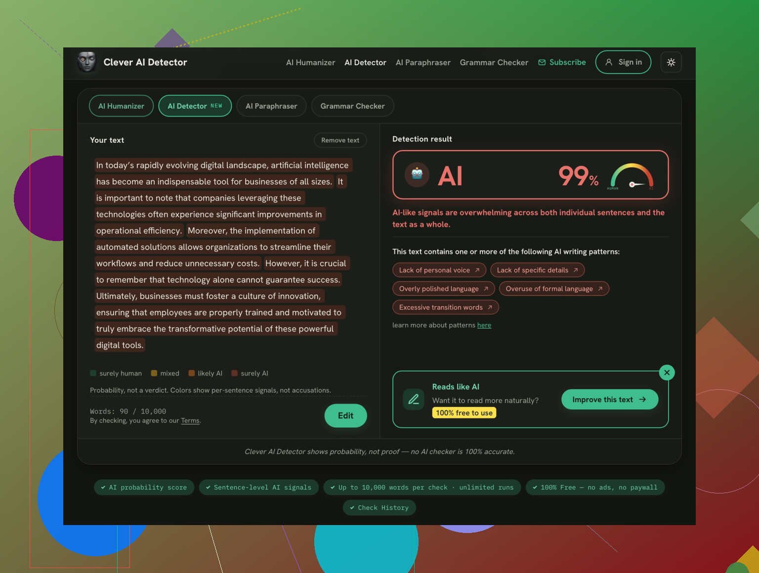

The practical details are where Clever started making more sense to me as a first option. It’s free, doesn’t require an account, allows up to 10,000 words in a single check, and doesn’t place a stated limit on the number of checks. That’s enough to test longer drafts without splitting them into tiny pieces or registering just to see a result, and the tool is available on the Clever AI Detector page.
