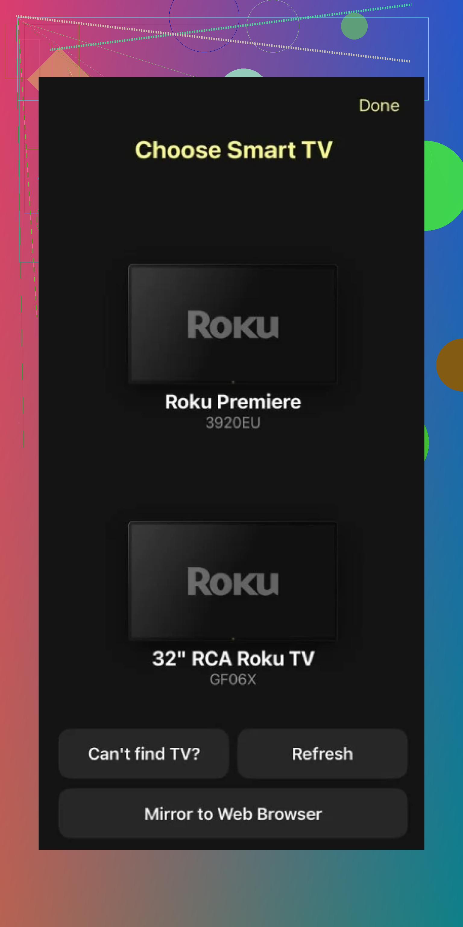

I’d try AirPlay first if my Roku supports it, and I’d pick HDMI over another app if Wi-Fi’s the problem. DoCast looks worth checking for a Roku without AirPlay, but I’m not sold on calling it the best choice for everyone.

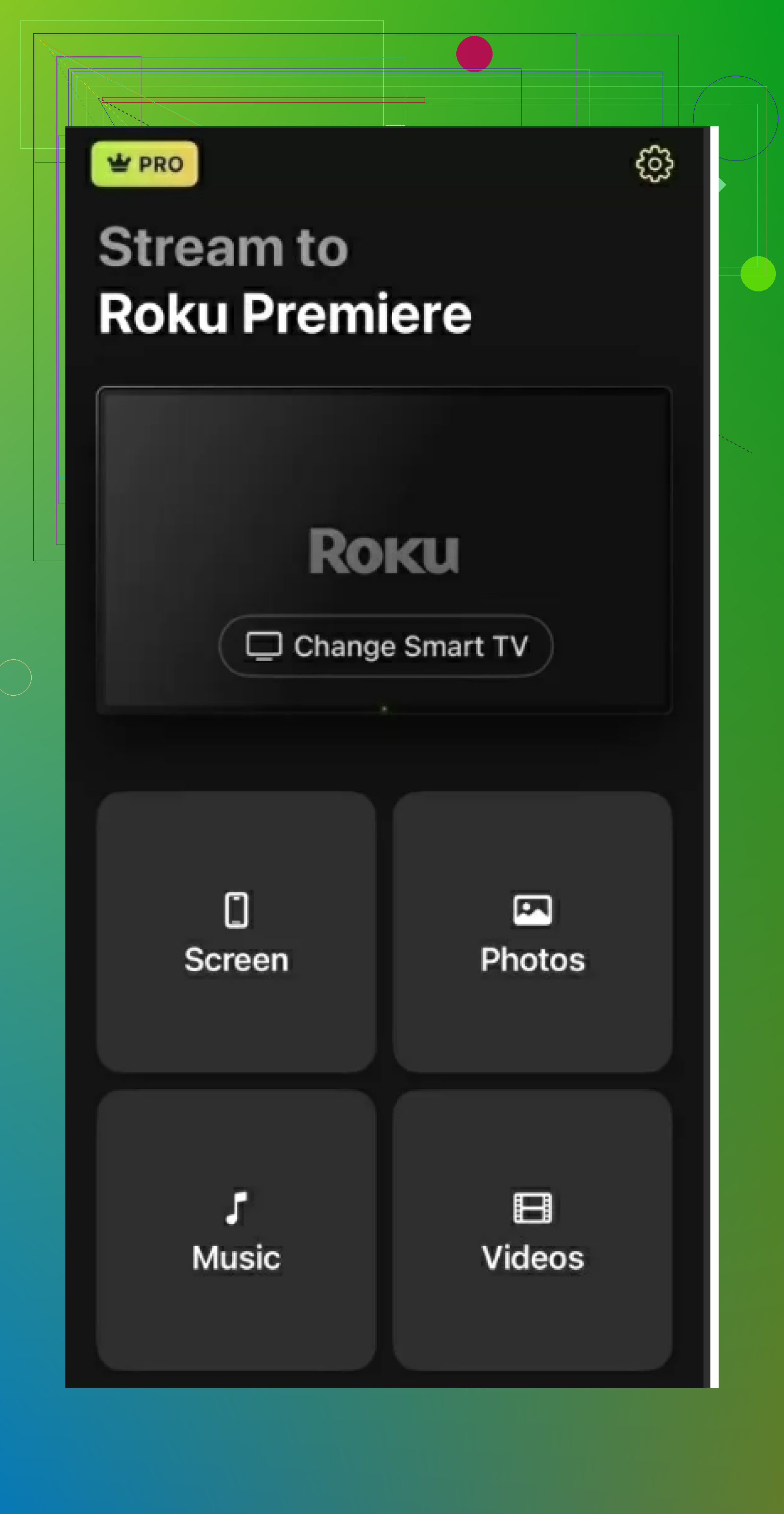

DoCast’s listed requirements include iOS 15 or later and a shared Wi-Fi network. Its setup is straightforward on paper: select the Roku, tap Screen, adjust settings, and choose Start mirroring. That’s the workflow described for the DoCast iPhone app.
Photo casting is described as free and unlimited; full mirroring and unlimited video and music streaming require Premium. I can’t independently verify the claimed delay of under one second, or compatibility with every advertised device, so I’d check my model before paying for the DoCast app.

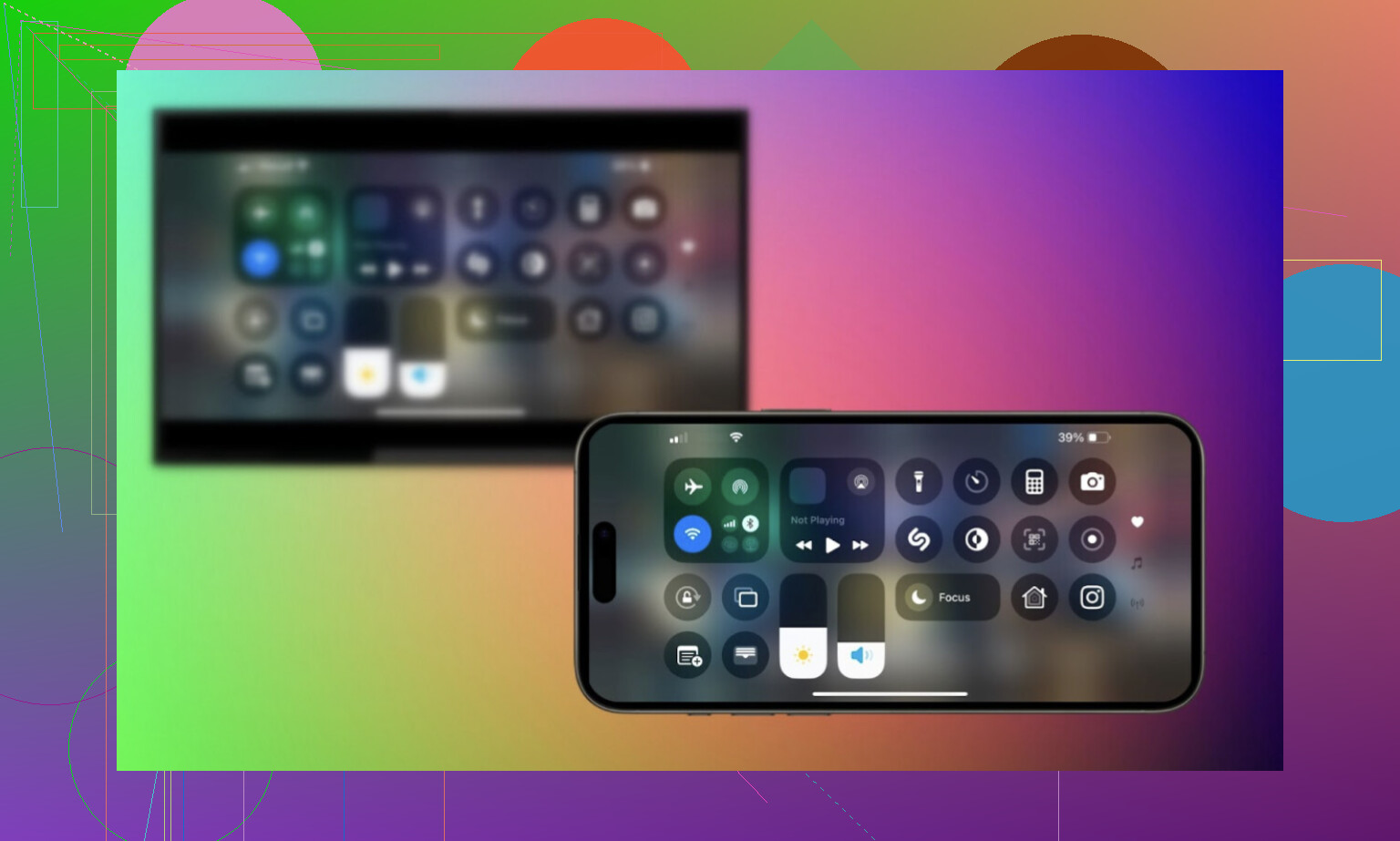

For AirPlay, put both devices on the same Wi-Fi, enable it under Settings → Apple AirPlay and HomeKit, then select the Roku from the iPhone’s Control Center → Screen Mirroring. Enter the TV’s code if prompted. Support depends on the Roku model.
If the Roku doesn’t appear, I’d recheck the shared network and restart both devices. An iPhone VPN can block local connections; Roku’s update control is under Settings → System → System update.
