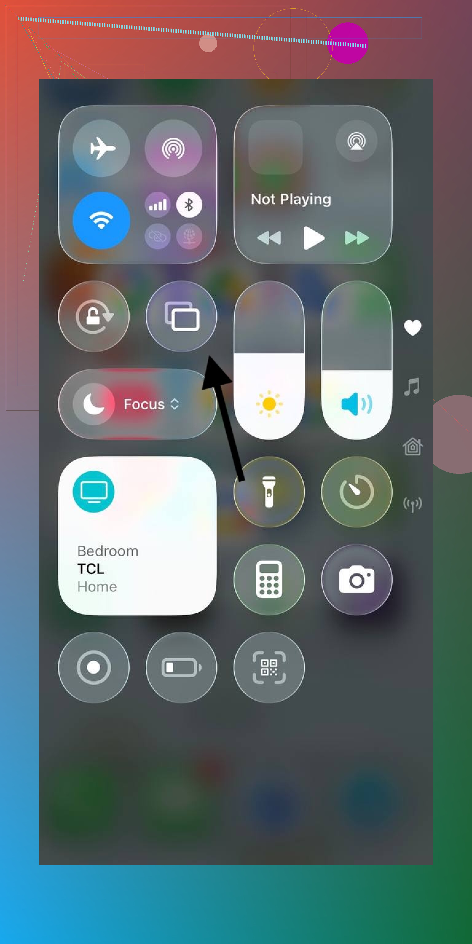

For AirPlay mirroring, the iPhone and TV need to be connected to the same Wi-Fi network. Open Control Center on the iPhone, tap Screen Mirroring, and choose the TV from the device list.
The TV may display a code the first time you connect. Enter that code on the phone, and the full screen should appear on the TV.

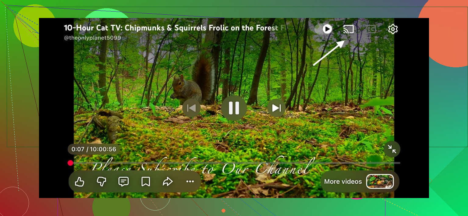

Use Casting for Netflix and YouTube
If the goal is just Netflix, YouTube, or another streaming service, don’t mirror the entire phone. Mirroring is unnecessary for that job and can drain the battery faster.
Open the streaming app, start the video, tap the Cast icon, which looks like a rectangle with Wi-Fi-style waves, and select the TV. There’s no extra app needed when the streaming service already includes casting.
This also avoids the black screen people often see when trying to mirror Netflix or Prime Video. That isn’t usually a broken connection. Those services intentionally block mirrored playback with DRM protection, so their built-in Cast function is the right method.

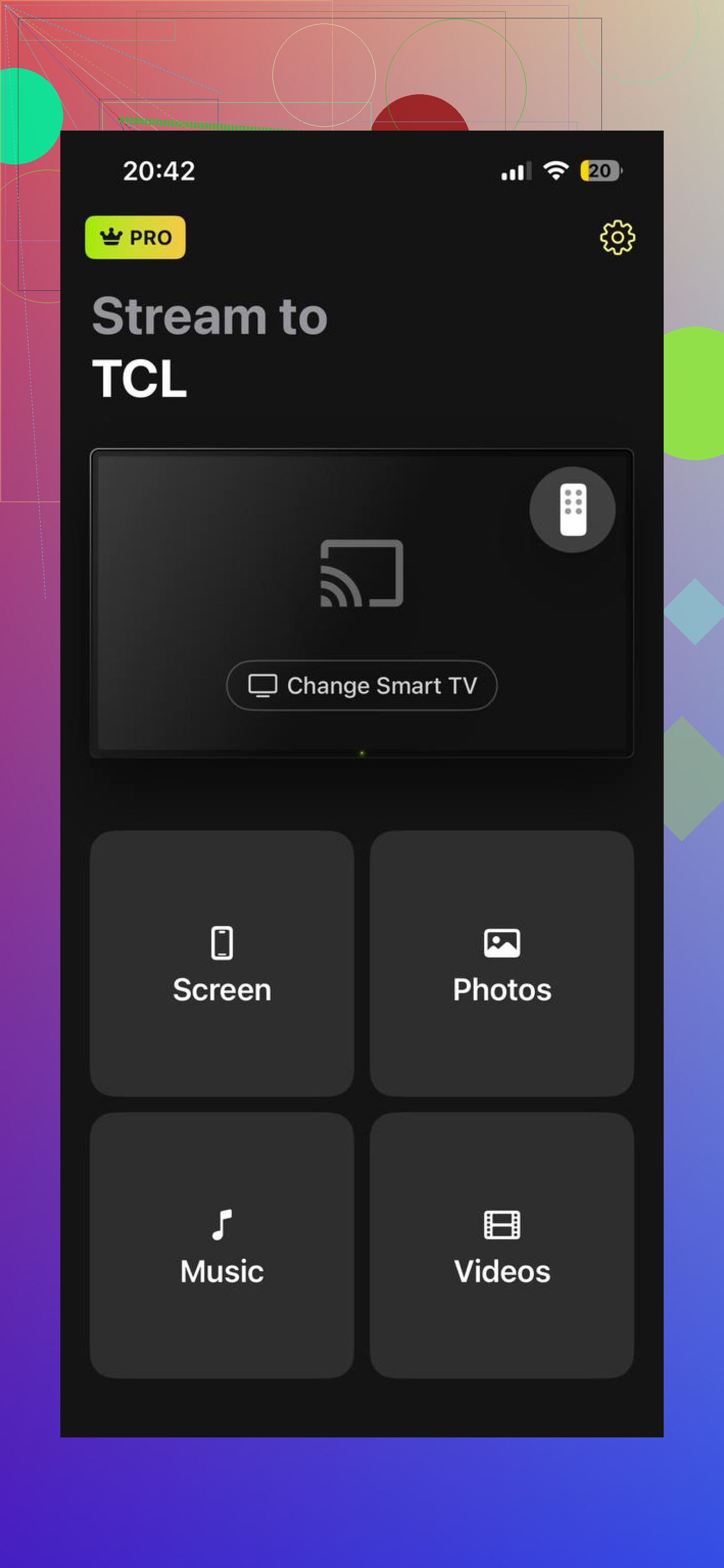

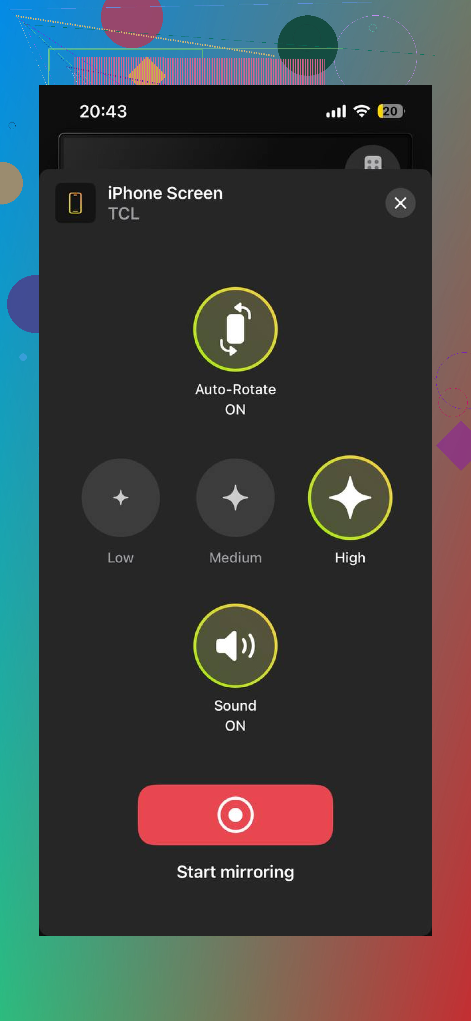

For a Chromecast, Fire TV, Roku, or DLNA device without usable AirPlay support, you’ll need an app to connect iOS with the TV. One option is the DoCast mirroring app.
It’s fairly barebones and doesn’t add ad clutter to the basic process. Open it, tap Choose Smart TV, select the device on the same Wi-Fi network, go to the Screen tab, and tap Start Broadcast. It’s my fallback when a TV isn’t compatible with AirPlay 2, rather than wasting time forcing an unsupported connection through DoCast.
